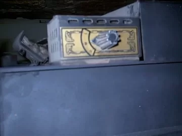

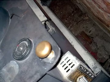

the pictures may help
  • [Hearth.com] earthstove 100 series lighting
Thank you! This info helps out tremendously, I was doing it all wrong. I would lift the wire flapper in the back when lighting the fire then drop it and try to use the dial on the side to regulate the heat, I think the only reason my stove would work was because the door is warped and lets air in on the bottom.
