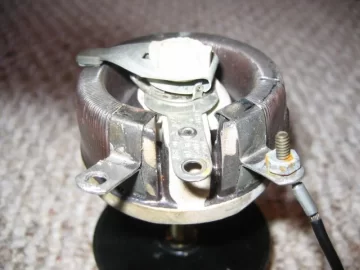

A rheostat for controlling the blower speed is a very direct and simple motorcontrol. Basically it's a variable power resistor. In other words a potentiometer capable of handling much larger currents than potentiometers normally used in electronics.
A great advantage of rheostat motor control is simplicity and easy repair... if it stops working... replace the rheostat.
A disadvantage is the inevitable heat loss dissipated inside the rheostat. This heat loss is worst when it is turned down, since the voltage over the resistor winding will increase and the same current will flow through both the blower and the rheostat ( P = U x I ). From this we can conclude that there's no heat loss in the rheostat at full throttle.
A typical rheostat will have to be designed in this way in order to handle the excessive heat: A resistive element wound on a ceramical base, and with a wiper sliding on the side of the windings to change the resistance.
Picture of an opened rotary rheostat:
[Hearth.com] Earthstove MP40 fan issue
For a rheostat to fail like the one in WildBill's MP40 stove all the individual turns of the winding would have to be shorted... and that's not at all unlikely. Some conductive material from the wiper must have been ground off and settled between the windings making an electrical connection. One way of fixing this would be to open the rheostat and carefully clean the contacting surface with a wire brush (a soft brass brush will be optimal ).
Disassembly of the rheostat in a MP40 for cleaning may not be possible, though, so it will be necessary to replace it with a new one. Here's link to an aftermarket version for only $26: (broken link removed to http://woodheatstoves.com/rheostat-for-whitfield-pellet-stoves-p-325.html)
