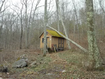

I have soon work to do very soon so I picked up another saw. I had a few Ash trees uproot on me in last weeks nor'easter. The tree in contact with the shed not too much of a problem. The liability tree is the one that got hung up in the crotch of a tree right behind the shed. That is the much bigger problem involving climbing and roping off and can't get any heavy equipment back there. Pictures can be deceiving, these are easy 90 footers.
