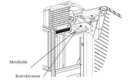

Veee85, Ecoteck has made a cleaning manual in Danish with some very detailed illustrations of what needs to be disassembled in order to make a deep clean of a Francesca stove. There is a metal shelf under the exchanger tubes that only can be cleaned when the baffle plate has been removed. The Firex 600 bricks must be removed too. Compressed air can be used to clean this area, but it makes a real mess of dust in the room. According to the manual a bottle brush should do. See sample from manual below.
To clean the internal ash traps you must have access to the ash clean-out ports, See illustration below.
Google Translate should be able to translate the text, but the illustrations are very clear and detailed, so they don't need much explanation.
The complete cleaning manual is attached below. 14 pages, 1,07 Mb.
