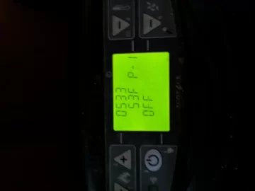

I recently acquired a house with an Elana installed in a corner with a short horizontal 3" vent pipe. On first start attempt I got a no depress error.
I disconnected the flue and cleaned the venting and the stove thoroughly. I scraped and vacuumed the flame trap and heat exchanger, removed the firex panels and cleaned behind them, and brushed and vacuumed the rear air passages accessed through the inspection panels. Everything was VERY dirty and ash laden. I also disassemble the exhaust blower and cleaned it out.
Now when I attempt to start, my error message is gone, but none of the control panel buttons will do anything. #3 button will not initiate start up....#4 button won't access menus.....after the start cycle and cleaning the display says off and panel won't respond to any inputs.
Anyone have any ideas?

Make sure the connector at both ends of the ribbon cable (between the top LCD display and the internal control board) are properly seated.....or you static zapped the top LCD display or controller electronics when you disassembled the stove for cleaning.
I checked the ribbon cable connections and they're fine. I'm skeptical about the control panel being zapped because it displays the startup routine just fine. If the panel needs to be replaced, are they available anywhere?
Seems like a marginal design that they put such a marginal component in a place that is likely to have static discharges on a regular basis .. ......cool, dry air...go figure.
I assume you tried unplugging the stove 110VAC for a minute, and then retrying?
You pushed and held the power button (#3) for a few seconds before releasing it?
Have you tried to turn-on the stove with the remote control?

Yes, I tried unplugging it several times with no success and held button #3 down till my finger was sore...lol....but you may have hit on something regarding the remote. I assumed there was one available because I saw the antenna hanging out of the back. The problem is that I don't have the remote. Do you know if they're all the same, or are they matched to the receiver in the stove? And thanks for the parts info!

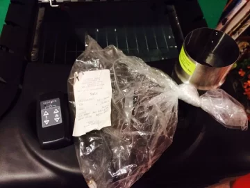

Picture of the IR remote for your stove : the 4 button remote is in the picture, on the left.
