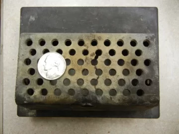

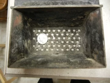

After a complete cleaning of an Elena that I purchased used, the only thing needing attention is the bottom of the burn pot is getting brittle and cracking. See photos [Hearth.com] Ecoteck pot needs help[Hearth.com] Ecoteck pot needs help
1. I can attach a support plate to the bottom with matching but slightly larger holes to not restrict air flow.
2. What type of material should I try?

No idea. My email bounced back from the email link from Ecoteck to US distributer. Its more of a high heat issue and will continue to crumble and if I attach a plate now may get a season or two before having to TIG a new bottom on. Will have to check with a good friend that rebuilds scale steam locomotive boilers on what I should try and use.

Having watched the fire now for a period of time it's probably because of the igniter hole continuing to feed extra air with the pellets dropping on top creating the extra heat in that area. If they had the igniter on the end away from the feed drop probably would not have the problem or simply have made the pot heavier like the slatted floor surrounding the pot. Will try and make a plate to insert in the pot or tig in a layer of stainless in the burn hot spot.
Is the burnpot stainless or cast? My stove guy says they are switching to cast. My burnpot is doing the same thing after 2 seasons
Stainless I am pretty sure. No way cast could standup or be bent with the thickness my current pot is. There is two problems their engineers screwed up. Probably someone fresh out of college. The ignitor placement and the thickness of the bottom of the pot. Its one thing for the pot to crack, but to be consumed. My old countrysides have stainless pots. Most of them crack but do not get consumed. Material is heavier and does not have the ignitor feeding extra air right on the bottom in one spot making it like a blacksmiths forge.
Those cracks are known as creep failure and are the result of heat caused expansion and contraction. All steel can be deformed in a wood fire, it is only a matter of getting the temperature in one spot a lot hotter than in a nearby area. The temperature will be the hottest is when the wood is actually in a burning charcoal (carbon) state and there is a constant blast of air (think a blacksmith's forge), the second hottest is where there is a constant flow of air and fuel. The fact that the burn pot is a pattern of holes and metal also leaves weak spots and places that can get hotter because the heat isn't draw away as fast as in other areas (usually this between the holes closest to the fire and air flow).

Stainless burn basket. The burn pot looks like steel plate. So the high heat is more destructive in this case. The coldness really surprised me - like grabbing a beer out of the fridge ;) (couldn't resist!) I know rapid cooling is used to harden steel but wondered if it helped create the problem.
Would fabricating a new basket out of plate eliminate the problem or a different grade of stainless? We have scraps of steel left of varying thickness from other projects and my brother-in-law is a demon on welding (Hubby's good but his brother's better!) What design changes might be needed?

Run hours approximately 6,000 - primary heat, second year. Burn pot now has continuous crack but no material missing yet. Yes, could just buy another burn pot but the crack started before end of year one. If a better, more stable material can be found that will resist cracking that quickly, why wouldn't you switch to that instead of throwing $90 out the window yearly?
My stove is on the second short season. The running of the ignitor is not the problem but that the air is still continuing to come in from it and the fuel is dumped directly on the strong airflow like heaping coal into the middle of a forge. You can watch the flame deflection in the pot around the ignitor port. I don't have access to any metal testing equipment nor the acid to do a quick check for nickel. If its simple cold rolled steel I will simply replace the bottom with some heavier metel. Will take more time to drill the holes than weld together. I don't think any stove should have to have a simple vital part replaced that regularly. I have a 83 Whitfield that has all original parts. Going into the greenhouse this spring after this big storm allows me to put the top on.
