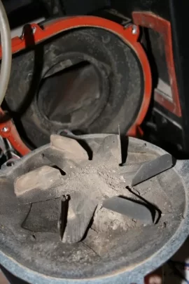

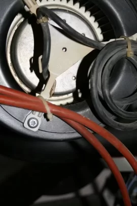

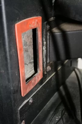

Pics of the Elena Air insides ...
  • [Hearth.com] Ecoteck - Will parts be available for Elena Air Plus?
Wow, she gets as dirty as the American stoves! Any other pics of what you have done on her?

Took photos of the numbers off the epm-papst combustion motor, vacuum switch, and sintex 45 capacitors just for reference.
Paint in firebox starting to peel so will need touch up. Tried out VHT on flame trap to see how that will hold up - stunk up my house in the curing process and my oven doesn't go to 600F - the final step.
