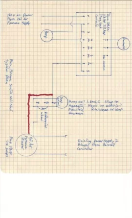

Hello all,
I'm finally on the home stretch of my long awaited install of my effecta boiler!
I would like to give a big shout out to cebulskig and mark schoellig for helping me with all of my questions/install!
Anyway, in an attempt to give those guys a break, I figured I'd ask this question here first.
I'm having trouble figuring out how to get my aquastat to work with my pump relay and thermostat.

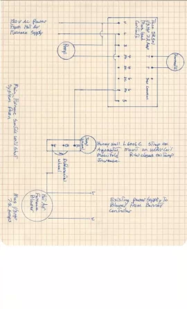

Right now when the thermostat calls for heat, it turns the pump on fine, but I couldn't get the blower fan to kick on once the aquastat reaches it's desired temp.
So, I figured a way to make the blower turn on whenever the aquastat see's the desired temp, regardless if the pump is on. This causes the blower to randomly come on and off.
Any thoughts?
Pic 1 is my wiring diagram
Pic 2 is the bypass I did to get the fan working.
I guess I didn't mention that I have a wtax.
Ty,
erin

Hello all,
Any thoughts?
Ty,
erin

Hello john, I was reading about your install on another thread and it sounds very intriguing. I'm wondering how to incorporate that sort of system and the costs associated with it for my older style effecta?
Anyway, I'm wanting to hook my fan so that when the house thermostat tells the relay to turn the pump on the fan will only come on when the pump has power.
I think I'm getting what's called thermal syphoning? and the aquastat is reading warm enough water temps even when the house isn't calling for heat.
Does this make sense?
Erin
Erin
