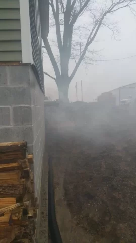

I would be careful with a horizontal termination on the flue pipe. This is what i tried, to get going for the winter, with the intention of putting a block chimney in at a later date. Im in the process of going vertical bc the wind was actually making the stove back up, and on one occasion on last Sunday night, filled the house with smoke and fumes.
