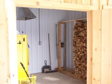

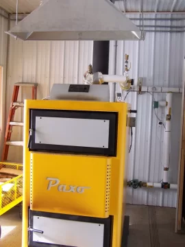

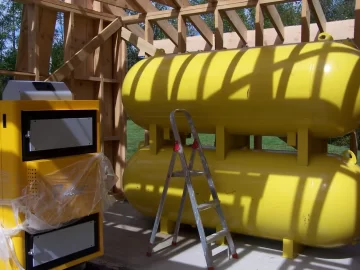

Been there , done that... EKO 60, 1500 gallons of thermal storage,, moved to a another home, back to a wood cook stove and Woodstock Progress Hybrid.... Power goes out you don't have to worry about circulators.. I say keep it simple... I burn half the wood I use to using a couple of wood stoves, plus I get to watch the fire and cook my food at the same time... Yup a little wood mess in the house, that's what dust pans and vacuums are for. I had a lot of money tied up into pipe for the ground, thermal storage, the boiler , chimney, two expansion tanks, plus a good size insulated building ... I'll take a wood stove any day and never look back...
[Hearth.com] Efficiency question, gasser vs. cat?[Hearth.com] Efficiency question, gasser vs. cat?[Hearth.com] Efficiency question, gasser vs. cat?[Hearth.com] Efficiency question, gasser vs. cat?[Hearth.com] Efficiency question, gasser vs. cat?
Charley, your explanation really tells the story and proves what I decided 4 years ago. The only real hang up I had was insurance. The insurance companies do not care about outdoor boilers a long as they are a certain distance from the house. The indoor wood stoves they ask a few more questions and could charge a premium.
There is also a much more equally spread heat with an outdoor boiler if you use radiant piping. Some tie to the furnace and install a heating coil. The outdoor, non gasification boilers, are wood hogs. I do not have the time it takes to feed those animals. I have two brother in laws with those things and all they do is cut wood. I bet 8 to 10 cords a year for each.
Probably 10k if you do a lot of the work yourself and you will still use more wood, even with the gasification. But maybe not, some of those guys in the boiler forum have gotten it down to a science. I just couldn't get there.
