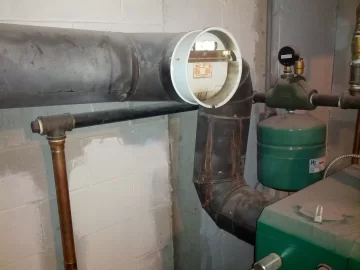

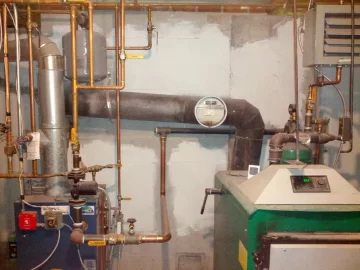

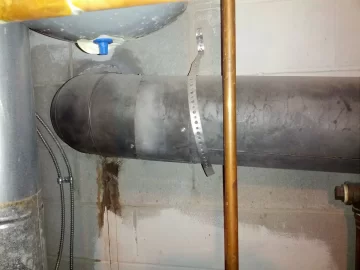

If I were to op the top door, while there is a small burn going, smoke tends to come out the front through the door and not out the damper an the flue. Does this mean that I have a draft issue? I attached some pics of how it's currently piped out.

Ya you do. thats a long horizontal run. Turn that 90 out of the unit so its at a 45, get rid of 2nd 90. And make the third 90 turn at a 45. That will vent much better for no $$$.

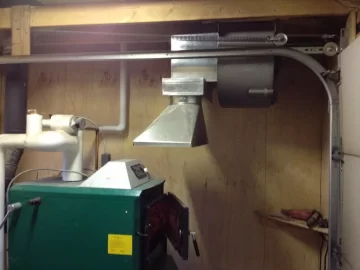

I even put a hood above me eko in an outside installation. The building is small and would fill with smoke and it was bothering my lungs. Used an old furnace blower and had a sheet metal shop fab up the duct work. This thing really sucks the smoke. You have to open the garage door slightly or it will pull air from the chimney. Best thing I ever did.
