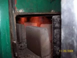

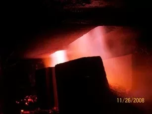

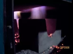

Secondary flaps are at 6 turns out after bottoming them out on the boiler inlets and the primary air is set preaty low about 1" from being totally closed..The fan shrouds are about 1 1/4" open I just got done reading IN HOT WATER's post on make up air so I am going to confirm this is not the problem..The boiler was hot when I tried to work the gasification, it worked best just after I loaded it and brought the chimney temps up, so far chimney temps are very low like 150 or 200 that seems low to me..
I think the manual says 10mm open on the primary which is less than 1/2in. I think the reasoning is to have less air in the primary and more pressure for air on the secondary. I would download the latest manual and set it up by that and go from there. I set up my sons 60 and my 80 with it and they do run better at those settings.
If the secondary holes aren't lined up with the refactory right (3 0-clock and 9 o-clock ) you won't get the air into the secondary and get good gasification. The fix would be to turn the tubes to line up and make sure they lined up lenght wise also. If they weren't I would think that would be a warrenty issue as they could only come that way from the factory. I don't think this is the case but because of the history of not working proper it is something to check. From what I've seen the quality of the eko's has been good but there can be a mixup once in a while. It looks like they have been making improvements as they learn also.
leaddog
Leaddog I checked the secondary inlets to the refractory they are both riding at 3 and 9 oclock..I'll download the new manual and see what I can make of it..I did make a lot of progress last night with adjustments, and another big thing was make up air I had to open the basement door to get much better gasification and stop negitive draft on the chimney after a fan cycle. What size are the EKO blowers and what size ductwork would I have to use to supply EKO 60 with air..(pics anyone)..Dave
