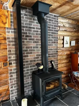

exactly one year ago, we removed our open fire place and installed a wood burning stove (Osburn 1700, EPA certified, with secondary air tubes). Everything was done professionally at rather large cost. We have a regular forced air gas HVAC to heat our house and only run the stove in the evening for maybe 4h to get a little extra warmth sitting by the fire. We have been very much enjoying it, but I am not sure if we can justify doing it, given what I learned recently about its emissions.
