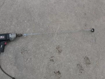

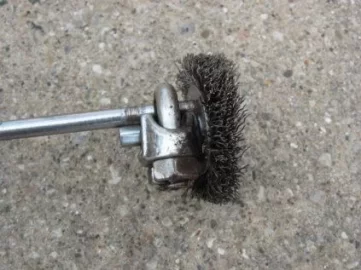

On the ashes in the top chamber, I just rake the coals when there burnt down quite a bit. The ash goes down into the bottom chamber through the nozzles and the larger pieces of coals stay up on top. Some people sort of the larger pieces from the ash out of the bottom chamber and toss them back into the top when reloaded with wood. I'm using storage so I burn the boiler till I recharge the tanks and then its shut down for a day or two so that's when I clean everything really well. With the heat exchanger tubes I have to clean them every so often as I have a older EKO without the cleaning turbulators, but if had the cleaners, I would clean them really good when I shut down the boiler for the summer. I made a attachment for a drill with a steel round brush and it works really, really well and allot easier than scrubbing the tubes by hand.

I wasn't burning really dry wood so I got quite a bit of "coating" in my tubes. Now that I'm cleaning the yard of branches and sticks which are super dry and burn really hot, my tubes are staying allot cleaner.
