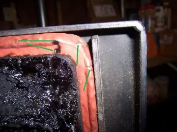

I installed a new silicone door gasket on my Eko Orlan Model 25 at the start of this heating season.
Several places have split; one split is letting gasses out. I contacted New Horizon to see if this was a known problem. Their response surprised me. They said: "Keep running, we will see what happens."
What does this mean? I think it means: I don't care if you have a problem.
The old-style gasket lasted for years.
Anyone else seen this type of failure?

Get some High Temp RTV and seal up the cracks. Personally I wouldn't classify that a failure, I have had that same gasket in place for 3 seasons now without cracking. You could also remove the gasket and put it in backwards, I am planning on doing this at the end of this season see if I can get some more use out of it.

Check the mating surface (jam) for any gouges or imperfections and hone the surface with a medium to fine honing stone. At least one burned spot appears to be a leak that allowed the fire to vent past the gasket.
For easier gasket install, use silicone spray lube.

I disagree. If your gasket has no issues after 3 years, and mine is cracking after just 4 months, in my opinion, that is a failure. I am asking the manufacturer to replace it. I see no reason that I should have to "seal up the cracks" on a new gasket. Regards.

The mating surfaces are smooth and have no imperfections. Several of the cracks are no where near where it contacts metal.
Mine only lasted 1 season I now just fill over the top of it with high temp silicone.

Can you stuff fiberglass rope in to that channel? I replaced a similar looking silicone gasket with the FG rope (about 1" dia) I found online. Bedded it in silicone caulk. Has worked well and is a cheaper fix.

Sorry it was a while ago. I did a search for 1" FG rope stove gasket (or a combination of things like that) and it came on a spool, 50'? for under $50. Also got a bunch of silicone caulk (HT) for cheap $$ as well but the color was random.
I hate the silicone gasket it is so hard to close the door and I backed it out as recommended and after several fires it still doesn't seal right and it is so tight it is ruining the door lock. I am pulling it out and getting the 1" fiberglass rope with silicone sealer. Furthermore, it doesn't seal well still get smoke out of the corners. Sometimes there is nothing wrong with good old fashioned technology.
Just my humble opinion.
The silicone burned off my lower door in about 2 weeks, been nothing but a pain in the ass.. I'll try flipping it over . Nothing but problems with both doors ever since purchased. good thing I have a separate boiler room.
When installing the silicone gasket to my Eko, I experienced leakage immediately. First assumption was a bad gasket or inferior installation on my part. After further inspection, I found the frame is not continuously welded and leakage was occurring at two of those locations. High temp silicone did the trick.
The silicone rope gaskets are good except for how they bend a 90 degree corner. If using in the future, I am thinking of cutting the rope to a clean miter and using RTV to seal the miters.
