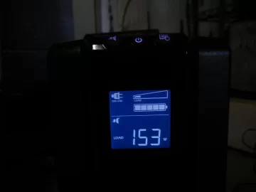

If the pellet stove used say a average of 400 watts with electric starts etc(pretty high average)for 30 days, 24 hours would be about 288 kilowatts+- at a national average kilowatt of 15 cents would cost 43.00 a month. I thought my stove was around 200 watts but that was with it running a circulator. Picture of UPS electric load panel with the stove running at full bore in test mode as no way I am going to fire today and mess up a clean stove and probably have someone get me in and have my head examined. [Hearth.com] Electric bill ?
If the pellet stove used say a average of 400 watts with electric starts etc(pretty high average)for 30 days, 24 hours would be about 288 kilowatts+- at a national average kilowatt of 15 cents would cost 43.00 a month. I thought my stove was around 200 watts but that was with it running a circulator. Picture of UPS electric load panel with the stove running at full bore in test mode as no way I am going to fire today and mess up a clean stove and probably have someone get me in and have my head examined.View attachment 137030

Wish I could find another for $100. Had another stove's UPS go south this summer:( Guess ten years might be their limit. Cheap insurance and nice to know events with the panel.

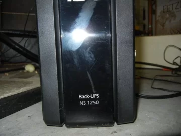

Bioburner and TimfromMA, what UPS is that you two use? How happy are you with it? I'm in the market.
[Hearth.com] Electric bill ? By APC, has several screens to show most everything, Volt,Watts, time remaining,events etc. I got it at Sams club. Will probably be looking at another next week. Keeps things running for over 20 minutes, stove and circulator. Very rare to have power out in winter of over 15 minutes but wind makes for surges and some dirty power as we are at end of a leg in the country.

I have the XS 1300 by APC. I bought in Office Depot. We have a lot of power outages here out in the country. This is more then enough of a supply until I get the generator started. My main concern is keeping the memory in the stove from going back to the default setting. My house gen does everything but the Electric heat, Dryer, and stove. Ceiling fans are in every room.
