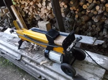

I picked this one up from CL for $65, guy said it was not working. I was able to get it running OK.:)
I don't know what brand it is but it looks a lot like the one it the pic above.
I set it up on some boards to get it to a comfortable height.
It works surprisingly well for a small machine.
So far I have split a good amount maple. It did get stuck a few times on some larger pieces but I did eventually get them split.
I have that exact one. It was sold by Grossmans as iron and oak or something like that.
With my back hand I press down both levers and use the other to hold the round. It'll treat you well. It has done 90% of what I've thrown at it. It doesn't owe me a dime.
