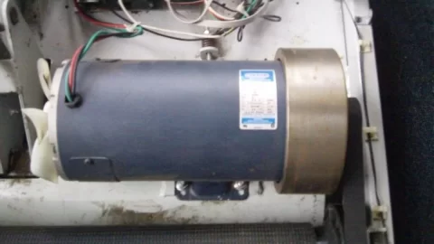

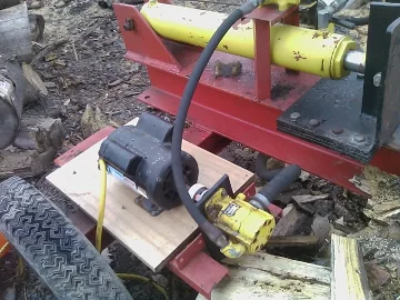

I had my wife's treadmill apart adjusting the belt and couldn't help but notice the motor under the hood. Very smooth and quiet. Turns out it is 4000 rpm, 3hp and max 10hp. The question for the crew is how does that work? The motor I have on my splitter says 5 hp 3400 rpm and draws 15 amps 220. This one says 21 amps 120. So what is that max 10 hp all about? Does it just long enough to split the nasties but would overheat under that constant load? My wife told me not to cannibalize her tread mill but hey if I can't figure out the belt issue I might as well put it to good use right?

It is a DC motor.
Most treadmill motors are not of very high quality but guys are using them on machinery because of the variable speed and torque.
You need an aftermarket drive or rob and adapt it off the treadmill.
They are famous for wildly enthusiastic hp claims. ;)

Thanks for the link...I didn't know the hp ratings were such a manipulable number on electric motors. Is the 5hp on the motor I am currently using from a rotted compressor real or is that overstated too? I know that thing draws current. I have it on a pair of 20 AMP breakers and every once in a while when I am pushing the splitter I trip the breaker. Maybe a couple times a year.

I believe most motor's hp rating is determined by how much energy they use. So a poorly made and inefficient 5hp motor that generates lots of friction, heat and wiring leakage gets the same hp rating as well built 5hp motor.
Quality motor's like Baldor, I don't think fudge,,, chinese imports are at the other end.
Also those old cast iron motors from the 40s-60s always seem to have more real "power" at the tool than modern motors with the same rating.
You could run a Panzer tank on some of those old 3 hp monsters.
I have a 5hp (actually the motor is a Emerson "special" compressor motor without a hp rating on the tag, but calced to be about 5hp) electric motor on my splitter, the motor is quite, the pump is what makes the all noise at 3450 rpm.
