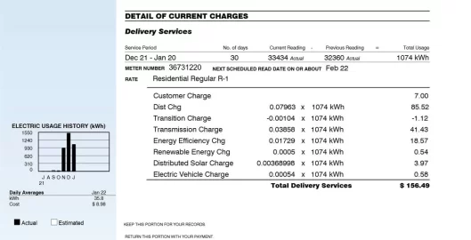

Our rate is $.10, but by the time taxes, delivery charges and such, it TOTALS to about $.23 per Kwh. Attached the bill portion that shows all the add ons based on Kwh usage.
