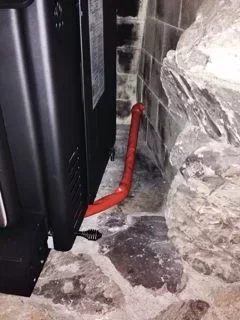

I didn't care for the cord sticking out either so I ran some SO cord inside conduit and protected the conduit with a high heat sleeve. [Hearth.com] Electrical Connection Question for Wood Insert

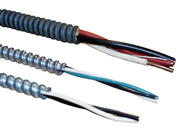

I have an insert and the cord runs out along side the face corner of the hearth. The problem that I find is the cord is just electrical cord. Where the cord lays is where I like to place my clean out tools right after use. The problem is the tools are hot and might melt the factory blower cable. What I need to do is remove the OEM cord and run armor bx or mc cable down to the basement for power. This way the wiring is protected from heat and any other form of damage.
