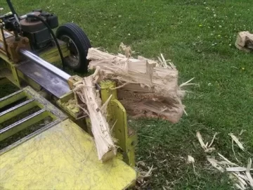

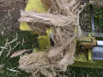

like this????
Oh, by the way, if your looking to rent a splitter - this stuff would of laughed at a 20 ton. It made my big boy grunt.

Jags said:
like this????
Thats Nasty!
smokinjay said:
Jags said:
like this????
Thats Nasty!
Yep, but I'll bet it seasons quick and makes nice kindling! :cheese:
