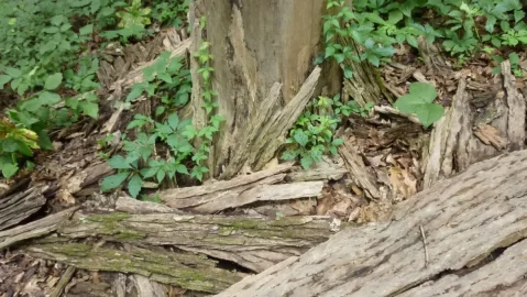

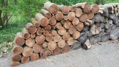

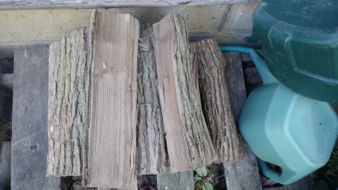

Have you got any bark or split pics? I love it as firewood, even though it's nothing special in the BTU dept. I see 21.6 mBTU/ cord...between Cherry and White Ash.
This is the big boy, then bark in the second two pics:

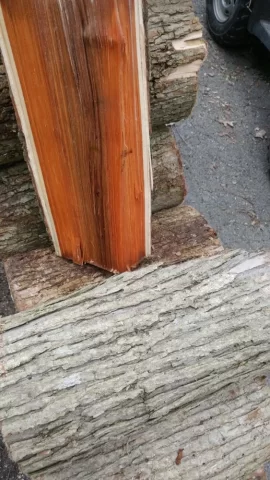

The blow-over wood..fresh, wet.

Was this a woods grab, craigslist score or what? I guess that an American Elm growing in the woods might have less branching and be a little easier to split. As with any wood, you're likely to get several different opinions on how hard it is to split. My experience is mainly with Red, and it is splittable by hand but I generally feed it to the power splitter. The fresh one I posted pics above, popped apart easier than the dead ones generally do.

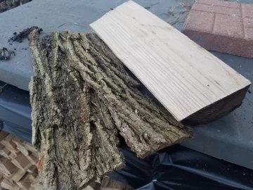

Here is a pic of a split and what little bark was left.
Wow, really straight-grained. Not surprising it split easily. Definitely not Red Elm..split would look more pink, and the bark isn't right.

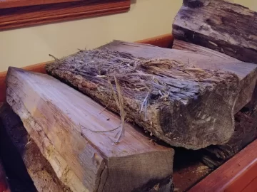

Wicked stringy.
Split green. Next to some straight grain white oak.
It's not red. No slimy inner bark, no red color.
It's not chinese, partly because here it dies off readily from dutch elm disease.
That leaves american elm.
