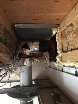

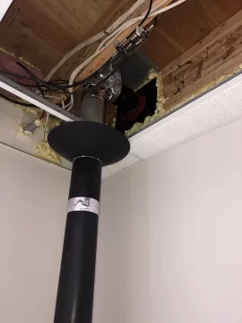

Hi again. I am responding to a post I made nearly a year ago, to share a bit more information and ask for help. I still have smoke leaking into the house and I am confident it is coming in somewhere between the elbow and the thimble in photos. I can smell smoke there, which seems to build when the stove is burning/hot. I have tried shining a light on it in the dark but still can't see where it is leaking. As you can see I have taped all of the Simpson Duravent joins, put high temp silicone where the vent penetrates the wall, and spray foamed around rim joist and floor joists. No fire alarms going off, but a REALLY annoying smoke smell. At least I've narrowed it down to this location... Any advice on finding the source of the smoke?

I hear you. I wasn’t the installer but I surely would have done a cleaner job. Here is the pic you asked for

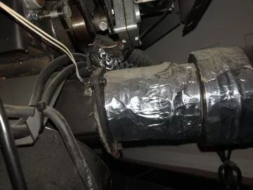

I may be wrong but it appears that one of the joints isn't taped. When in doubt seal it up. I've added an arrow to point to the area my ancient eyes are drawn to.
[Hearth.com] Elusive Smoke...
I'd also check to see that all the aluminum tape is well stuck down. I've seen it lift off if the original surface wasn't cleaned up enough. Skin oil is sometimes enough to prevent adhesion.
What is with all the tape? Did you pay for that installation? I’m guessing there’s no high temp sealant on the stove flue. Take the tape off the stove flue and see if it has high temperature sealant on it. If you’re getting smoke that’s my guess.

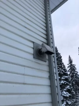

Thanks Hugh. All seams/joins are well taped and I have examined all of the vent and can’t see any obvious voids. I think the wall thimble could be an obvious spot for smoke to enter. Have a look at this pic of the exterior. Should the siding have been cut away and the thimble sealed to the sheathing? The rough opening is really rough with a large gap through the sheathing. I have sealed it up on the inside but...

The thing about silicone is that once you've juiced a joint up it becomes incredibly difficult if not impossible to ever get it apart should you want/need to. Aluminum tape on the other hand can be pulled off more easily if need be.

The pipe has to be a minimum of 12 inches from combustible materials on the outside of the home. You could add a 6 inch piece to that and then cap it. If it’s siliconed where the pipe goes through the thimble and around the thimble you’re not going to get any smell from the outside.
Agree, think vent cap should be further from the house

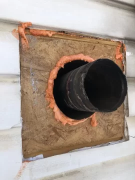

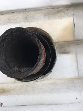

Yes - have checked for smoke in the dark but can’t find any. I have sealed up everything obvious on the inside of house but never really looked at the outside of thimble. I think I found my problem. Huge gaps around the outside of the thimble and the outside face of the thimble wasn’t sealed or even close to the wall sheathing.
I closed up the gap with fire-rated foam and trimmed away the siding and tightened up the thimble against the wall sheathing.
My theory is that the smoke was getting sucked from the vent, around the thimble and back into the house. Time will tell if I was correct.
