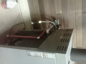

i use bettle killed pine and birch. i seem to throw a couple large round pine in first ... then i some nice seasoned birch split that i plug it full with. What is great about this thing it takes quite a chunk of wood, it says 24 but a 28 will fit and a 12 inch diameter (one of) ... and it like it. loves the large rounds. I will post my piping but i have a uniquie situation. The house has two furnace rooms, one for the pool (which is now filled in and covered with cement), it has a geothermal heater that heats the slab, then a large house with another furnace room with yet another geothermal heater. So I had to connect the two furnace rooms and do the nessesary plumbing to make all this work. My plumber/pipe fitter was a friend who does theboiler work for our llocal school board... did a great job. I do have one hicupand that was the sizing of my heat exchanger. I had for the pool a 125,000btu heatexchanger.... and thats what the boiler is rated for so i thought great ..... but it just wont exchange the heat fast enough to bring the house water above 140 dgrees. The boiler is set at 170 degrees and it idles quite a bit... so i think i may need a bigger heat exchanger. what is someone elses experence ? do you need a larger than rated heat exchanger to do the job ?

ok >>> more pictures i get it..... ill work on that.

let me figure out more pictures for you guys

  • [Hearth.com] Empire 100 by Profab
I'm gettin a neckache lookin at yer pics . . . Make sure the ones of your wife loading the Empyre are right side up . . .ya don't want gravity doing anything strange ;-)
I can't recall what you have for a HX. Why don't you like the one you have?
Also can't help you on cleaning since your unit is NOTHING like my GW. Hence my interest. :-)
opps crap sorry about the photo's
get the lap top out !!! and is that the thing ... get the wife loading it ? wish me luck
