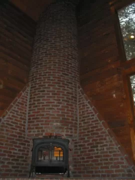

Good thought, but I just checked the Lowes website, and (as I sort of expected) all they carry are their "Summer's Heat" (aka Englander) stoves - These are steel plate stoves, and nice ones for the money, but like most, they are a top exit design. Because of our chimney setup we MUST use a rear-exit stove, with the top of the pipe not over 36" higher than the floor...
To change this would require MAJOR reconstruction and destroy one of the neatest looking parts of the house. (We call it the "Brick Rocket" - see photo )
Another minor constraint is that I'm somewhat limited on what I can use for a floor R-value - as best I can tell we only have about R-0.8 or so under the hearth, non-combustible but not great otherwise...
Far as I know, this limits us to a few of the VC's, Hearthstone, and maybe a few Jotul's. Englander, Blaze King, P.E. etc, are totally out of the running as they can't be made to fit into our install.

  • [Hearth.com] Encore Cat - one year later and it doesn't look good...
Now Thats Brick work!!!!!!!!!!!
Great picture Goose. Brick rocket indeed!
Seems like you would do well with a Quad Isle Royale or a Jotul F600. Sorry again to hear about the hassles. No stove should require this degree of maintenance. Maybe there's an inspector in MA that you can sell the Encore to?
PS: If you really would like to get an Englander, couldn't the old thimble be plugged and a new one cut in higher for the top exit stove?

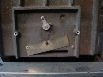

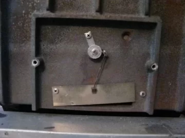

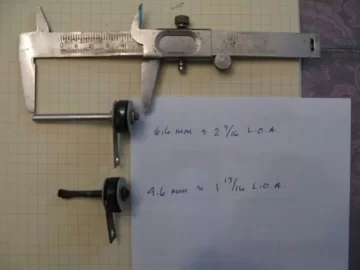

Secondary air thermostat gotchas. I recently replaced the probe in my VC WinterWarm (Small) and noted the new probe was not properly indexed. Photos show it well.
(1) See photo below with title "Length" showing burned away probe for reference. Burned away probe makes secondary thermostat run cooler, thus opening gate, thus allowing too much secondary air, thus LEAN mixture. LEAN mixture runs hot, thus HOT cat, hence warped metal cat housing.
(2) See photo below with title "Stock" showing probe installed before index adjustment. Stove and probe are at room temperature, but look at position of air gate -- half closed. As the stove warms up, gate will close too soon, creating RICH mixture, possibly collapsing secondary burn, hence SMOKE. If your new probe arrived mis-adjusted, this may partially explain your continued smoking.
(3) See photo below with title "Adjusted" showing probe installed after I re-indexed the coil relative to the fixing arm. Gate is now open almost to the pin stop, as I think it should be at room temp. Now gate will not close prematurely as stove warms up. This was easy to do with a small wrench and a vice, but you must be gentle. Also, in the process of this operation, I realized that I could have repaired my probe by making and threading a length of copper rod and fixing the old coil to it. So keep your old coil for a spare.
