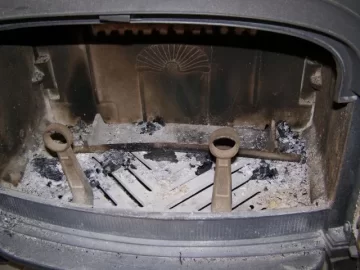

Our sweep used to do the maintenance on our stove, but he retired and we haven't found anyone else to help out, so I'm hoping someone here can give me an idea of what to do with this problem. The stove is 13 years old and it has never had this problem before.
The problem is that the hood that covers the catalytic converter keeps falling off. It only falls off when there's a fire going. Once the fire goes out and it cools down, we hang the hood back up. It just hangs from two little metal things that jut out. I can't find a way to hold it up better so that it doesn't keep falling off. Nothing looks broken, though I noticed that the hood itself is curved, but I don't know if that's its normal shape or not.
Any idea why it keeps falling off all of a sudden and how to keep it from doing it?
Thanks

Yep. Heat. And age. It is probably time to replace that throat hood piece, and maybe the firebacks also. The cast iron has been stressed to it's limit. Replace the worn part and you'll be back to normal. Do you have a VC dealer nearby? Does this dealer have a stove technician on staff? If not, you may have to learn how to do these parts replacements yourself.
Good luck,
Sean

I am with the others in that replacing the parts on this stove is a good move. One question that comes to mind is do you see the converter glowing> If so then it is working. If that is the case, then you might order the cover only and see if it has become warped and is just short enough that it is falling off when it gets hot. If you got it hot enough with a torch you might be able to flatten it out again. But, if you replace it and that solves the problem, all the better.
