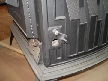

Interesting. On my 1984 VC Resolute the secondary air intake IS adjustable! I will try to post a pic. It consists of a tear-drop shaped cast iron piece which can pivot and cover up to 100% of the secondary air intake.

I would like to see that pic of the part you described. I think quite a few people (maybe not a majority, but still a good number) need to add something like this to their stove. But really almost anyone could POTENTIALLY experience the problem given unusual conditions (like extreme low temps and high winds) so I think almost every stove should have such a device to use in case of emergency. Its a basic safety issue. Of course the person has to understand the purpose and not restrict secondary air for no reason, or that would defeat the purpose. That's why it should be something that is a bit of a pain to access and adjust.
I agree...I would like to see a pic. I have the large DW everburn. Temps in these parts can be pretty low and we often see 50+ mph winds. I experienced a "thermonuclear" event just the other night. Thanks to Trader's suggestion of restricting the air intake, I believe I can solve the problem and prevent it from happening again.
Here is a photo of the secondary air intake on my 1984 Resolute. I've never posted a photo before. Please let me know if its viewable.
