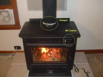

I've been cruising through the forum since the spring and reading up on different topics. I just got my woodstove set up and started my first fire tonight! I've grown up with a wood stove in the house but this is my first house and my first wood stove of this kind. I have attached a photo so those of you unfamiliar with the stove can get a general idea of the question I'm about to ask...
My main problem with the stove thus far has been being able to completely control the stove. I bought one of those handy dandy thermostats that you stick directly on the stove pipe via magnet. I can't seem to keep the stove up out of the "Creasalt" range. I'm trying to figure out exactly how to use the air controller and the damper effectively. All othe stoves that I have had havent had the air controller, just the damper on the pipe.

That looks like the 12, not the 13 correct? Your manual should tell you which way is "open" vs "closed" for the air control.
Basically after you've done your break in fires, in order to get the stove up to temp (at least how I do it in my 13) is to have a couple of medium size splits on the bottom with a fire starter in between them. Light the fire starter, then I criss cross kindling pieces up to the top of the fire box with another medium sized piece on the top of the pile. Leave the door cracked open until your stove top temp reaches around 250-300F, then close the door. If your wood is dry, it should take off from there and you can begin to incrementally begin to close your air control.
If your wood is less than well seasoned, you may need to keep the door cracked open a little longer.
I think the issue may be the damper. That damper looks like it is a bit closed. You should be able to control the burn with just the air control. Closing the damper would be used if you had too much draft or really needed to slow the stove down. You need to let that puppy burn and then close the air down a bit at a time.

I read a lot of reviews on the stove before I bought and most people complained the stove was hard to start, I haven't had that issue at all. My main problem is getting to stay at temp when I close it up. So if I'm understanding you guys correctly, when I fill the stove for the night and head for bed I should just use the air control on the front and not mess with the damper at all?
In that photo the damper is closed a bit, I took the photo while I was messing arund with the stove trying to figure out exactly where I wanted the damper and the controls set.

Well, I have to be the contrary guy here. With a 35-1 stove like the 12 I say that you leave that lower air control mostly open and control your burn with the damper. The 12 is the only 35-1 stove out there that even has an air control other than the pipe damper. Since it does not have a secondary air source in it shutting down that lower air control just chokes the fire.

Agreed, sell the 12 and buy a 13. you'll be glad you did. I owned that stove and worked the heck out of it for two winters. The most productive way to run it I found was to keep the air control wide open and just close the damper when the stove got up to temp. This would slow things down enough to make the stove only slightly less inefficient. If I remember correctly, I was informed just before I sold it that the damper wasn't designed to be used for combustion control, only for a chimney fire and the air control was the primary means of controlling the fire.

the "flip top" damper in the collar of a 12 fp is not a draft control. it is intended to be open when the unit is in use and to be closed in the times it is not. this is to help prevent warm weather downdrafting which occurs in some homes. it is intended to be used as you would a damper plate in a fireplace chimney. to close the chimney when not in use.
