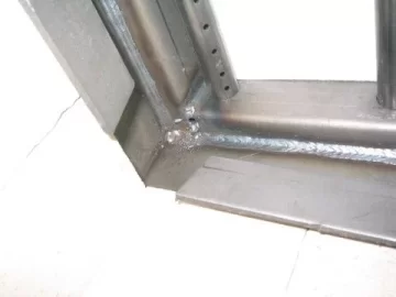

I have been working to get the insert instaled and today found a 1/2 weld burn hole in the left, rear bottom corner of the secondary air channel iron.
Is this going to be a big problem?
I emailed englander to get their responce today.
Could I just get a stainless screw and put in the hole to block it off?
Also I had to remove the fiber board to get to my flue to bend it flat as I had a hard time geting it into the top of the insert and Englander had rtv the back secondary tube to the fiber board and half of the thickness of the board broke off will it be ok that way? I did flip it over.

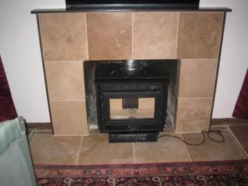

Looking forward to burning this winter.
Have 23 foot 6in 316ti insulated liner. Should be a good draft.

My 30-NC has a flubbed weld in exactly the same place. Since it was behind the fire brick I didn't see it until a pencil flame showed up when it was burning. I filled the hole with furnace cement four seasons ago and haven't looked at it since. All of these stove companies QC on something you light fires in in your house makes me crazy.
I would get them to send you a baffle board. Those things are thin enough as it is. How they think you are going to install an insert without taking it out first is beyond me. I know why they started tacking them in for shipping but it made it a pain in the ass to do installs.
Edit: I wouldn't mess with the secondary air inlet.

Ah. Yeah the weld flub in mine is at the base of the manifold in the back but it is the same type of hole. I would dip a stainless steel screw in furnace cement and put it in the hole. Don't go changing the air intake to solve a problem you don't have. All that will happen is that the stove won't burn right and you will be disappointed.
