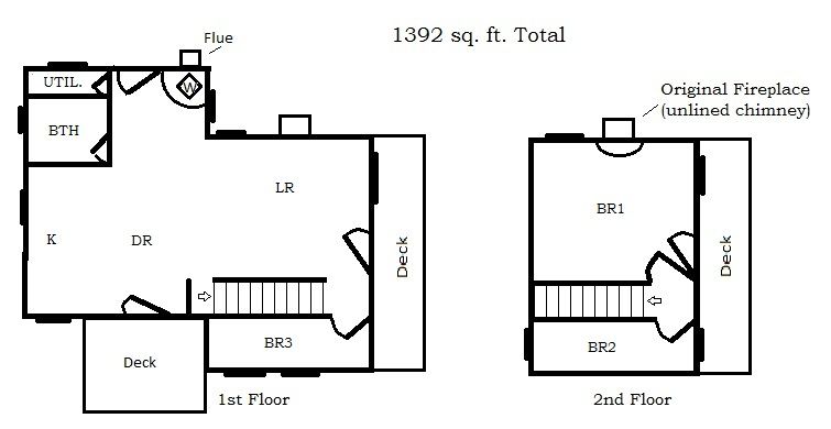

For fun... here's a rough layout of the house. The 1st floor is basically one large open area with a fairly low ceiling (I can stand on my toes & touch it & I'm 6'0"). I'm not expecting to heat the upstairs with the wood stove, but the warmest spot in the house when our current stove is burning is the stairway. The right half of the house was built around 1898 (along with the upstairs) the left half was an addition added in the 1940's and is one level.

I really think the 13 would heat the down stairs perfectly fine, the main appeal of the
30 is the ability to bank a coal bed down longer. Wood is our main source of heat.

I would do the nc30, you can always have smaller fires to adjust your heat curve and have the insurence of a larger firebox for times like these when its very cold. The foot print of the nc30 really isn't much larger than the 13, it's around 6" or so, the 30 does weight about 420 lbs but that's because of the heavier steel, like the other poster said, take the door off and the fire brick out and it makes it lighter to move, also you can take 2x4 and strap then between the pedestal and fire box which gives a little more leverage to move, you won't be disappointed, I'm running a blaze king princess right now, it's a great stove, but when I do my addition on the house my second " helper" stove is going to be englander

30-NC, without a doubt.
