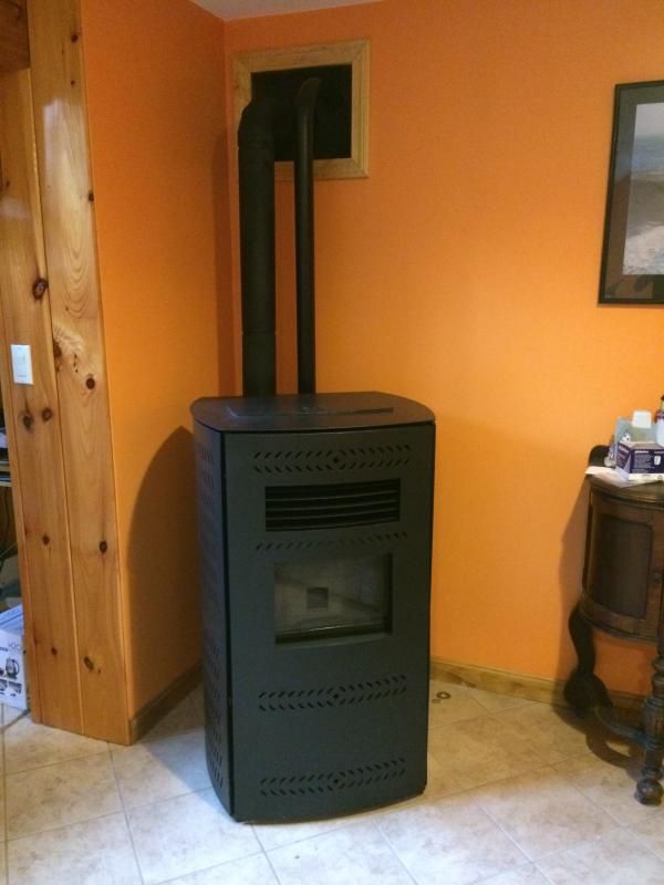

'Hate resurrect an old thread, but I recently (November 2014) installed an Englander 25-1P, as I write this I'm on my second ton of pellets and going strong.
I got a good deal from AM/FM energy (factory second). My installation is kinda unique as I'm below grade; 4" exhaust vent pipe, with a custom 2.5 mandrel bent for outside intake air. So far I love it! This is my first pellet stove after many years of burning wood, so I'm still learning. My first ton of pellets (Stove Chow) although burned well produced a ton of ash, My current, and second, ton (Blazer) burn great also with a quarter of the ash. [Hearth.com] Englander 25-IP
You could have started a new thread! Thanks for the pics:)
How is it doing heat-wise?

Nice job! Welcome to the Imperial Club!
I could have started a new thread, but there's so little online review of the 25-IP. We Imperial owners need to stick together.;lol The stove is situated in a downstairs family room of 500 sq ft, with an open staircase leading to the main floor (newer modern home). I typically run between 3 - 5 settings. Much higher and I have to start stripping off clothes. Right now with temps in the low teens outside ::F, I'm at 4 and it's cozy warm. I use about two bags a day with it at 5. I still burn some oil (radiant heating) for the bedrooms, and hot water. I don't have too much to compare it to. But I am happy with it, so far.
