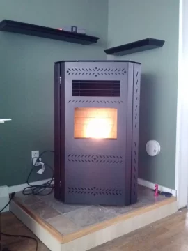

Finally installed the new stove.
Venting is Duravent 3" pipe
(45Deg)->(15"out)->(3'up)
OAK is installed,
Thermostat connection is pending, I want to run this for a few days to get a feel for it before i hook it up.
So far I am very happy with this stove. It is kicking the heat out with the North Americans I've got.

Very industrial, contemporary design! I think the smoke/CO detector should be further away, to prevent false alerts.
Definitely move the detector. The heat from the stove will eventually damage the unit. Had it happen to me and mine was a little further away. No fun for the ten minutes driving home after the neighbor called and said the alarm was going off!
Thanks for the Comments, I could move the detector, that is one of the carbon monoxide detectors, theres one at the other end of the room, one in the hallway, one over the basement stairs and one next to the propain boiler in addition to the smoke detectors in the house. That one has been there next to the old stove for 2 years with no issues, but this stove gives off much more heat so i may need to take that advise.

Very nice!! Does that unit have tubes for an exchanger?
I don't think it has tubes, at least it doesn't have top tubes like my old stove. And I'm not sure what is behind the back wall. I can take a pic of the fire box when I get home.
Pretty sure it's just a box heat exchanger around the firebox.
Page 44 of the manual has an exploded diagram that's pretty informative if you zoom in on it. Firebox is just enclosed within the larger heat exchanger box. The exhaust does go up to the top of the firebox, past the baffle plate and then down through the holes behind the fiberboard and finally out the vent. Not sure if the back of that channel has any features to increase surface area or if they would help. I believe you need to be careful to maintain a high enough temperature in the exhaust to prevent condensation.

Its a lot Taller than you Expect, But I really like the Hinged side doors, makes maintenance a lot easier
I like it! Very modern design. I hope they did something to increase the surface area for heat exchange, even if it's just waffling or 'V's. Don't worry about the exhaust temp. That topic has been beaten to death and it's basically BS. Suck as much heat out before it goes out the flue.
