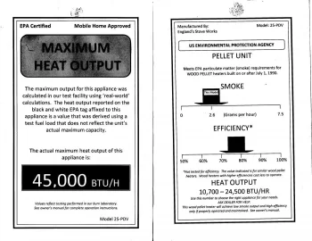

looking to see if anyone can confirm the btu output on this stove. englander site didn't say what it was. A few sites say 24,500. And I've also seen a few places mention 42,000 btu. I'm looking to upgrade and the stove I was looking at was 40,000 btu. Don't want to get another stove and it has the same heat output.
[Hearth.com] Englander 25-pdv
Apparently there are two ratings. See the image attached
"The maximum output for this appliance was calculated in our test facility using 'real world' calculations. The heat out put reported on the baslck and white EPA tag affixed to this appliance is a value that was derived using test fuel load that does not reflect the unit's actual maximum capacity."
EPA tag heat output = 10,700 - 24,500 BTU/Hr
Facility Test results = 45,000 BTU/Hr

Have to watch which is input BTU's and the Output BTU's
avg BTU ratings on pellets are around 8500 a pound That would be your input
multiply by the combustion eff. of the unit (Mike would know that at Englander) my guess would be 92-96% range
Then mulitiply that by heat transfer eff. (again Mike) I won't even attempt to guesstimate that.
That would get a true BTU output for you.
Be careful reading sales and EPA hang tags usually go off feed rates in pounds x 8500 avg BTU in pellets then the units actual eff. rating for both combustion and heat transfer. This way I find gives you a more acurate a number. IMHO anyways
That's a huge jump From what they claim huh. I'm looking at a used ST.CROIX. It's says it's rated at 40,000btu. But I wonder if it's stronger then my current stove.
On max heat setting that stove feeds in 5.1 lbs per hour if memory serves me right.
Lets say 1 pound of pellets is = to 7500BTU.
1 x 7500 = 7500 BTU per hour minus 10% for lost heat = 6750 BTU's per hour.
5.1 x 7500 = 38250 BTU per hour minus 10% for lost heat = 34425 BTU's per hour.
This should give you some idea on the max heat output in BTU's +/- 10 - 15% based on the pellets that you are feeding the stove.
Some heat is lost in the exhaust, so a stove will never be more than 88% efficient, most stoves are between 72% and 86% efficient. Some stoves from Europe claim to be 92% or higher, I have yet to see a stove from Europe and play with one, so I can not comment on them.
Edit: For the 25-PDV to produce 45,000 BTU, it would need to feed more than 6 lbs of pellets per hour on it's max setting.
