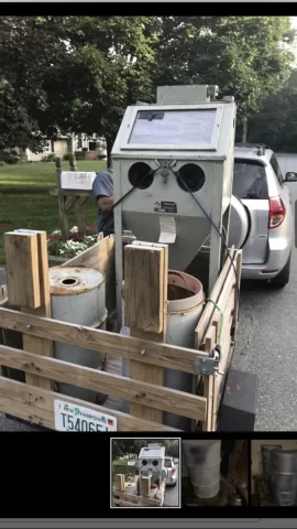

Hello
I got an abrasion blasting cabinet for $150 cheap and it does a great job using white aluminum oxide to clean up the wear plate, exhaust fan blade and the impingement plate:)
See pics

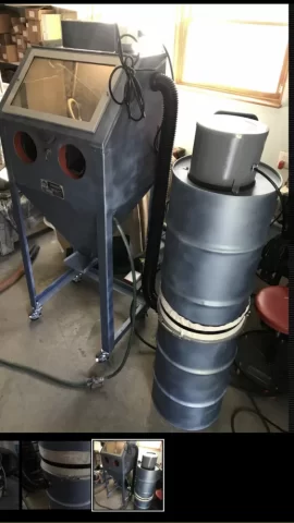

I refurbished the abrasion cabinet to make it look new. :)
Harbor Freight sells them too. Theirs are 19 gauge steel and this commercial cabinet I got is 14 guage and fits in my shop nicely and has a much larger dust collector with a motor! :)
