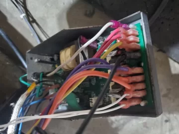

Recently my stove started throwing an E2 code after about 5 seconds of turning
The stove on. Once the E2 code pops up, the room air blower comes on and

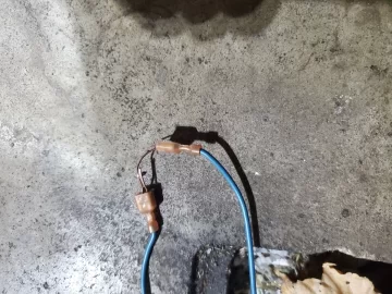

The stove does not start. All vac switches are bypassed and stove is clean to include
The vac tubes and ports
Any thoughts?
[Hearth.com] Englander 25 pdvc E2 code [Hearth.com] Englander 25 pdvc E2 code [Hearth.com] Englander 25 pdvc E2 code
Have hear of these getting "stuck"on E2.Perhaps try unplugging stove for a bit of time,and/or try resetting the control board.I would leave switches jumpered,right now.Probably one of them has a problem.

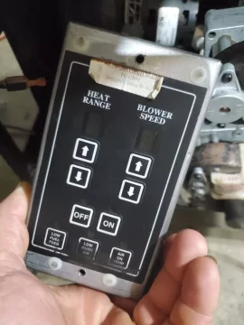

I wasn't aware they even had 2 button boards anymore.
