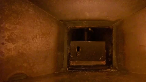

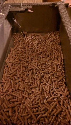

11 hours ago I topped off the hopper and set the settings at I for fuel feed and 9 for room air. And this is where I'm currently at in the hopper.
Close the restrictor plate, which is located at the bottom of the hopper as far as it goes. Factory settings are 6-4-1 for the lower buttons. Make sure you're in the proper heat mode, which is "d". Here's the instructions to verify your burn mode.. Unplug the power supply from the wall and plug it back in and within 4 - 5 seconds you need to press both the up-and-down blower buttons at the same time and in the window to the left you will see either A, B, C or D mode in the heat range digital display if you see anything other than D then use the up and down buttons to change it to the proper mode which is D.

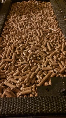

Thank you very much gentleman. I'm giving this a fresh burn test. Setting D 3-4-1 pellet restrictor maximum closed start time 11:10 am with one maximum filled hopper if 40#
Now for some questions. As the owners manual is definitely lacking in all the information that I received here. #1 What's A B C D. #2 why is the system not responding to my manual feed rate setting.
