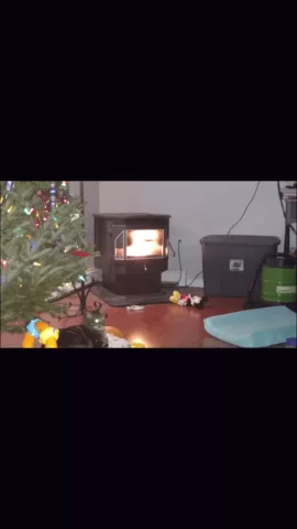

OK think I found the sweet spot for the angle iron on the airwash bar. Not the best pic but the dark spots on the side glass are black. The center glass is dark up high on the sides and the rest is spotless except for the top 3" of the center glass is cloudy. Over 24 hours on heat setting 1. Super minimal ash on the door. I also added lips on to the sides of the burn pot . now there is only a couple pellets that bounce out.
