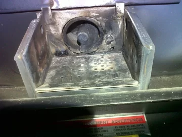

How often do other owners of this stove empty theres out? Once a day, every other day or.....
I shut mine down everyday, wait for the flame to go out and then pull out the small plate with air holes in it and dump what's on it in to a ash bucket. Does that sound about right or do others just let it overflow in to the lower section on its own? Then do a big clean up once a week or so? [Hearth.com] Englander 25PDV burn pot?
My neighbor just quickly reaches in with a long curved (bent) screwdriver blade and pull the ash buildup out of the pot and close the door . He only shuts the stove off for a good burnpot cleaning and scoop out the ashes every other day and sometimes longer.
I'll shut the stove down once a day to just dump the burn pot, coinciding with a refill. I'll empty the ash areas maybe once a week, depending on how full they are.
Eric
Fifth season with my 25PDV, and I do not run it 24/7, usually from about 4-5pm to bedtime, but all day on Sat and Sun......so every day before I fire it up i dump the content of the burn plate into an as bucket, use a putty knife (about 1 1/14" blade) to scrape ash and unburnt pellets into the lower part of the burn pot, then use a modified soup spoon (ground to have a sqare corner) to clean the bottom of the burn pot out, then I srcrape any residual clinkers off of the burn plate with the putty knife, wipe the glass with a dry paper towel an fire it up!!! takes a total of less than 5 minutes. Every Saturday morning I'll do the vacuum thing, removing the impingement plate and getting the modified hose of the vac into all of the recesses and holes and such,,,,,, and that only takes about 15 minutes,,,,,,,, I love my stove,,,,,,
John
We run 1 stove, sometimes 2, nearly 24/7. Our cleaning is nearly identical to what Murphy118 describes, but includes clearing the carbon off that lower auger tube. I also clean the venting and use a leaf-blower on it after 1 or 1 1/2 tons have been burned....we love ours so much we have two..:)
