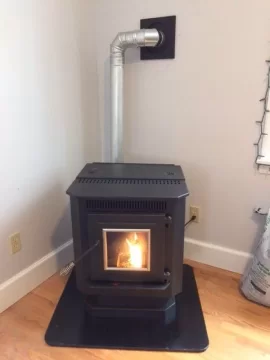

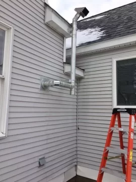

The stove vent is the simpson duravent. I exited the stove into a 90 elbow, up a 3' continuous section, a right 90 elbow to huge the wall, then another 90 out the wall and through the thimble. once out the wall it hits another elbow and then up the tee about 6 feet and terminates. I have had no venting issues even with all these elbows. The reason for the elbows was to tuck it in the corner and window vent clearance issues per the manual.
I also connected the OAK as directed and that is straight out the wall.
I will upload pics of the installation. I am at a loss as to why this thing is so underwhelming. I have been cleaning it very well (used to cleaning coal stoves which is much more time consuming) and I'm about to fire up the basement hunstman stove to help it out. Tomorrow ill be calling Englander for help on their end. Thanks for any advice in advance.

You have alot of 90’s in that vent that are killing your draft. Im thinking when you got outside you should have gone straight up.
Reactions: rich2500
If your used to coal heat your going to be dissappointed with pellet heat
Reactions: Pete Zahria
Too many elbows especially if your vent is 3".
I`d just do away with the outside stuff and put the end cap on where the vent exits the house.
The PDVC is a small stove and maybe borderline sized for your home ,depending on how well it is insulated.
Recommend EVL is 15 using 3” pipe. You’re pushing 35 with that setup. I’d remove everything on the outside for now and mount you’re termination cap there and see how it runs for a few days. Also do a search on here for Englander burn pot modification. If you have 2 holes under the wear plate,they can be plugged with steel wool to improve burn. I’m just not sure if it applies to the pdv or the pdvc
Thanks for the responses. I am considering increasing the exterior section to 4” pipe. The reason for the excess elbows is the inside location of the wall studs and then on the exterior is the vent termination clearances per the manual. If I go straight out or up I’m too close laterally to the windows.

There is no reason to have your outside flue that way.Either take it straight up,or straight out a bit further.Remember,the install specifications are for "vent termination",not the hole through the wall.Sometimes is easy to gain the clearance just by extending (straight out) a bit further.Remember "vent termination"(the actual hole where exhaust comes out,and think in 3 dimensions.
as far as i understand the termination limits in the manual, there is no reference to clearing windows by going out. it references vertical and lateral limits which i wouldnt meet by going straight out. My window position put me in a pickle where going straight up clears the first floor windows but then encroaches on the 4' clearance underneath the second floor windows. i had to jink the pipe over to satisfy the building inspector

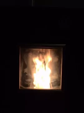

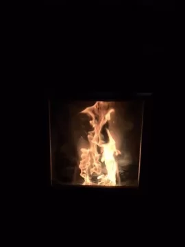

The success they have was getting a better and cleaner flame. What does your flame look like? Bright yellow and busy? Or yellow/orange dark tips lazy?
The flame looks pretty good. What low fuel feed setting are you using? It's the bottom left button. It should be set to 6.
That fire is too tall and looks lazy. You have a draft issue. Your going to have to do something about your vent routing or maybe get a diff impeller for the combustion blower to move more air

ill have to mess with the exterior vent set up and try running a bag with a straight out termination to see what that does. are there any standard temps to expect out of the front louvers ? i have a rutland thermometer from my wood stove on there to use as a measuring stick. getting 215 right now out of the section, slightly higher if i put it on the body of the stove
