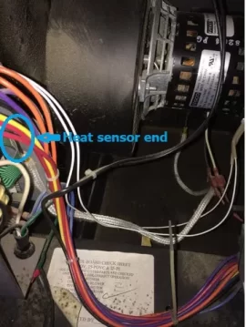

While your in there check to make sure the Heat Sensor screw is tight, If loose the stove not register proper temperature and turn off auger. Should be white cloth covered wire, but some replacement sensors had black cloth cover.
