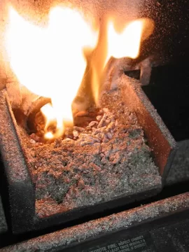

1st Time posting, but have been reading alot of info on this website. I have a 25PDVC mfg date is 01/05 it use to burn great, had all kinds of heat from it.. but recently in the past few months i've been running into all kinds of problems, have had to change an auger motor.. have had some issues with noise, no it doesnt seemt o be pushing the heat like it use to and i'm getting ALOT of ash build up and the temp in the house keepds droping after it runs for a bit.. can goto bed with the house arround 74deg.. wake up in the early morning and the house is down to arround 59deg. i've called ESW and have talked with tech about some of these issues... they had me reset the stove settings... clean out everythings that i can clean.. still not putting out like it use too.. HELP please... the picture i'm atempting to post with this is the buildup i'm getting with in the first 1hr of running and you can see where it doesn't seem to be burning the pellets completely... HELP HELP PLEASE :) OH use to beable to run the stove on a 3/3 and was toasty warm in here (roughly 1000sq ft) now its up on a 5/6 6/6 settings ..
  • [Hearth.com] Englander 25PVDC settings
mpdonovan. said:
cleaned out everything from the fresh air intake, the exhaust pipe.. bleow the burn pot.. getting frustrated.

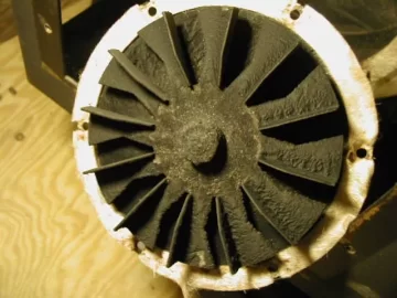

Gotta ask. Did you open the combustion blower and clean it out?
I was thinking the same thing. It's hard to tell but that flame doesn't look that strong. Maybe the combustion blower is pluged or going bad.
hmm.. can't say that i did that Bart... will have to see if i can do it.. when doing so will i need to replace a gasket?? still new to all this and i'm not that mechanically umm enabled.. lol if it was a computer i can rip it apart and put it back to gether in record time.. but when it comes to things like this.. lol i'm challenged. :) thanks for the info though, and i'll have to try that.
If you're real careful, you may be able to get away w/o breaking the gasket. I was able to take mine apart and save the gasket, but I got lucky. Probably wouldn't be a bad idea to purchase a new gasket before you take it apart.

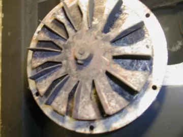

well took a chance and removed the blower.. gasket looks good to reuse.. the fan umm well heres what it looked like. gonna clean it out and see if this helps.
That doesn't look tooo bad to me.
I thought you said you had no mechanical skills! Pulling that apart w/o damaging the gasket isn't the easiest thing in the world to do...nor is putting it back on.
Doesn't look too bad if the housing and manifold isn't full of crap. But it wouldn't be the first time that a series of things caused a problem.
Well thought i did well till the vac got to close to the gasket.. :O LOL checking with local stove shop for gasket... crossing fingers that they call back saying they have one .. mean time i scraped and cleaned the fan the best i could.
On that stove there are two gaskets on the blower. The part you removed has a reusable gasket to facilitate cleaning. (If you keep the vacuum from eating it. ;-) ) If you remove the entire blower assembly you have to replace the gasket. They are available from Englander and they ship REALLY fast.

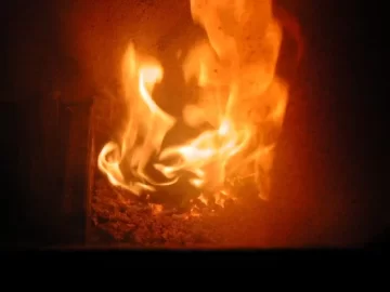

Thanks Peggy.. i saw that there were two different gaskets for this, well fortunately the local stove shop has parts that can cross reference to parts that i need.. so i got the gasket that i needed to replace and put everything back together.. we shall see what happens between tonight and tomorrow morning.. right now the stove is on 3/3 and its keeping the place around 74deg.. but its also a little warmer outside (22deg) but see if it drops through out the night into the morning. Thanks everyone that chimed in.. here's a picture of the flame now .. still doesn't seem to be burning like it use to. Oh.. And Peggy... I'll keep the vac away next time :red:

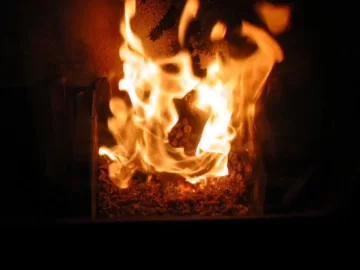

[size=3Well this morning when we got up.. it was 15deg outside and it was 66 inside... better then before.. still doesnt seem to be kicking out the heat like it use to.... guess i'll have to live with this for now. Also i took another picture, [color=red]should there be this much buildup of ash for 1 days running in the burnpot?[/color][/size]
Holy cow......I dont even get a half of a cup of ash in a 24 hour period....yikes
ok im back , been on a little (way too much work to do sabbatical) anyway , how long since the baffle plate has been pulled and the bottom of the heat exchanger has been vacuumed out? that is a lot of ash for a days burn , i get ash but not that much. looks like a bit of restriction somewhere. i'd start by checking the heat exchanger , pull the baffle from above the fire , reach down through the bottom of the clean out port (below the shelf) if you feel a lot of ash thats your restriction. i use a home made attachment for my love less ash vac, it consists of a 2 ft long piece of garden hose (had an old one laying around) i then wrap duct tape around it to make it thick enough so that i could stuff it into my vac hose, this allos me to get down into the back chamber and remove the buildup of fly ash that occurs. i do this about once every other week. nice job by the way of cleaning out that exhaust fan, bloody shame about the gasket , getting the blower off without messing up that gasket is not as simple as it looks.
stoveguy2esw said:
how long since the baffle plate has been pulled and the bottom of the heat exchanger has been vacuumed out? that is a lot of ash for a days burn , i get ash but not that much. looks like a bit of restriction somewhere. i'd start by checking the heat exchanger , pull the baffle from above the fire , reach down through the bottom of the clean out port (below the shelf) if you feel a lot of ash thats your restriction. i do this about once every other week. nice job by the way of cleaning out that exhaust fan, bloody shame about the gasket , getting the blower off without messing up that gasket is not as simple as it looks.
well i've pulled the plate out and vac'd out what i could, i'll have to get a peice of hose and try what you did.. i'll let you know how that goes.. thanks for the info and hopefully i can get this stove back up and running properly Soooon!

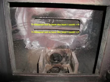

mpdonovan. said:
Well, i couldn't get a peice of hose yet, but used a very flexible brush to try and get into the baffle area... as seen in the picture, is this where you are refering to (written on pic) but couldn't get it to go anywere except to the sides here. where is this port that i can get a hose into? thanks, still getting huge amount of ash and i've left the shop vac sucking for awhile at these areas.
