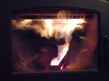

I already have two cords stacked and split for next year it is mostly red oak with some sugar maple. Attached is a pic of the secondaries I got yesterday. Here is my concern and I have been playing with it alot now but since the wood is not as dry as needed what do I need to do to get the secondaries going? In other words how do you know it is okay to start closing the air control rod? Also how much do you move it at a time just one inch and then how long do you wait to turn it down again?

I like to get the flue nice and hot before starting to reduce the air so 500 or so surface temp on flue, IF however your stove temp is climbing faster then the flue temp (which many report) you might want to start reducing the air when stove top temp is 500 or so. After some fires you wont be asking any questions and will have a feel for it, the dry wood makes it so much simpler and reliable. Dont let the stove get away from you as that happens also, hard to get these stoves slowed down sometimes.
The wood you mentioned Oak and Sugar Maple are known for slower drying times, make sure you get some less dense wood for quicker drying times and starting fires, the flue needs to get up to temp quickly to establish draft.
Okay with the wet wood for this season though, what do I look for to know if I should turn the air control down?
Flue temps and stove top temps or when the fire is burning wildly if no temp gauges.
Reduce in stages, maybe half the first time then a little more if the fire is responding well.
Kinda like driving a straight stick in a car, you have to get a feel for it.

The thermometers are a guide. For a first fire get the stovetop warmed up first. Say 350F+, then start turning the air down. We can't tell you how much because each setup and wood being burned is different. For our stove I'd be turning it down about 50% or until the flames slowed down. In a cold stove there may be no secondaries yet. Wait for 5-10 minutes until the flames regain their vigor, then lower the air control again until the flames get lazy. By now some secondary action should be happening and the stove top should be over 400F and climbing quickly. Repeat this procedure until you either have the air control all the way to low, or the flames stay lazy.
