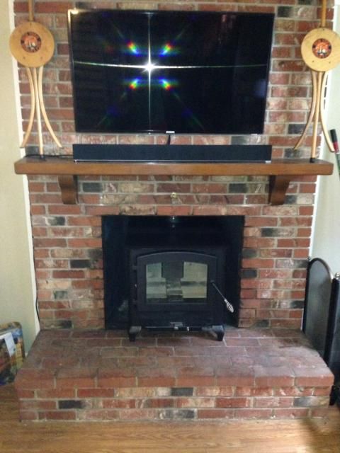

Just one tip for others who might stumble upon this...the short leg kit will make it work but don't forget about clearance to combustibles like the mantle if it is made of wood.

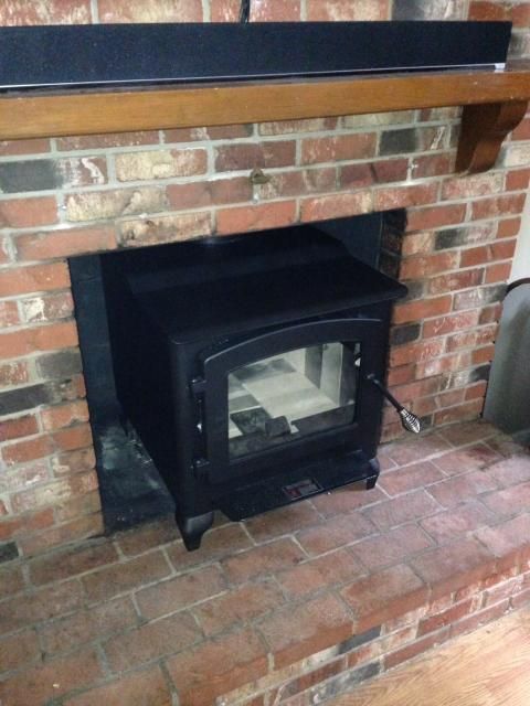

the highest point is the stove pipe connection and it is permanent. With the tall legs it is roughly 30"(I just put a tape to mine)
They sell short legs or... you would not be the first here to shorten the legs by just cutting part of them off. The biggest challenge will be shoehorning that monster into place. The OG legs have leveling bolts that will obviously be removed with any height mods thereof so you will want/need some small shims to level it up after you get it into place.
Also, note the factory fan sticks out the back so if you plan to use it you have to keep that in mind when calculating the depth of your opening. I modded my fan connection to fit my space and keep my straight shot pipe.
I'm assuming you'll be removing the smattering of combustibles from above the stove before you fire it up, right?

With clearance that tight I would definitely install a block off plate or at least stuff a lot of roxul up in there.
It's a good idea to find out exactly where the end of the flue pipe is positioned. I modded my fan so that the stove sits 2-1/2 inches from the back wall. Without modding it I would've needed 2- 30 degree bends from the top of the stove and would've lost my hearth clearance.
