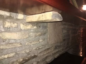

I'm wrapping up my nc30 fireplace install and I am concerned about my mantle height. It is 22 inches from stove top to the mantle. The stove extends 14 inches out of the fireplace. I built a test fire last night and stove top quickly got to 550 degrees and the bottom of the mantle was 120 degrees. What would the clearances be in the case of a woodstove in a masonry fireplace? here's a picture of the mantle before I installed the englander.

I think you might have to take down the mantle or shield it. Did you chop the legs?
Well you could do a cement board with a air gap under the mantle and match the stone that should absorb some of the heat. I couldn't find the distance to combustibles in the englander manual.
The Woodstock progress manual states 30inches to wood mantle above stove or 12 inches with mantle shield.
Reactions: stoveguy2esw
You could could make it look like the mantle is supported by the stone underneath it just leaving the 1 inch air gap on the sides
Reactions: crowescabin
As you can see in my avatar photo my stove has a wooden mantle just 22" above my Jotul F600. I put a heat shield under the mantle in the stove area that I made from some sheet metal and spaced it just a half inch below the mantle using pieces of copper pipe for spacers and you can barely notice it. When I shoot the mantle with my IR thermometer the mantle stays below 130F and is cool enough to put my hand on it.
Woodstock (and most other companies) defer to the NFPA211 for this clearance. so when there is NO listed clearance (which there is not as this stove was not tested as an insert) the 211 I what you refer to.
so you need 30 inches above the stove, or with a shield it can b 12 inches
Have you considered moving the mantle up higher?
I have but the mantle is supported by two protruding stones. I'd hate to mess with those. I may fabricate some sort of removable metal heat shield to mount to the lintel. I've been caulking with high temp caulk around my block of plate this evening.

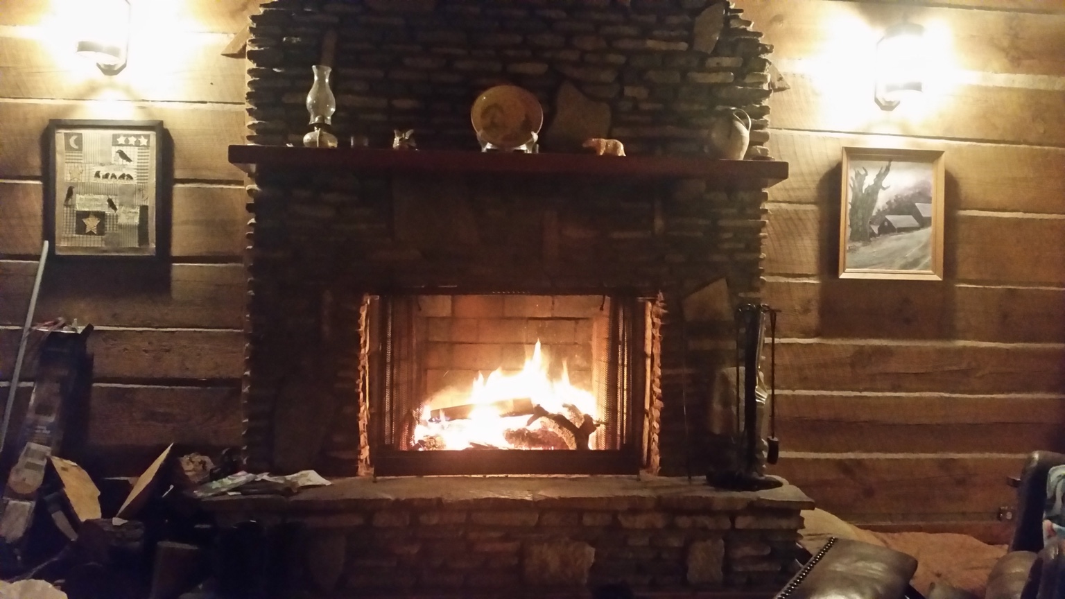

[Hearth.com] Englander 30 nc mantel height
I don't know from mantles but that bad boy looks great in that fireplace. And here's yer shirt.

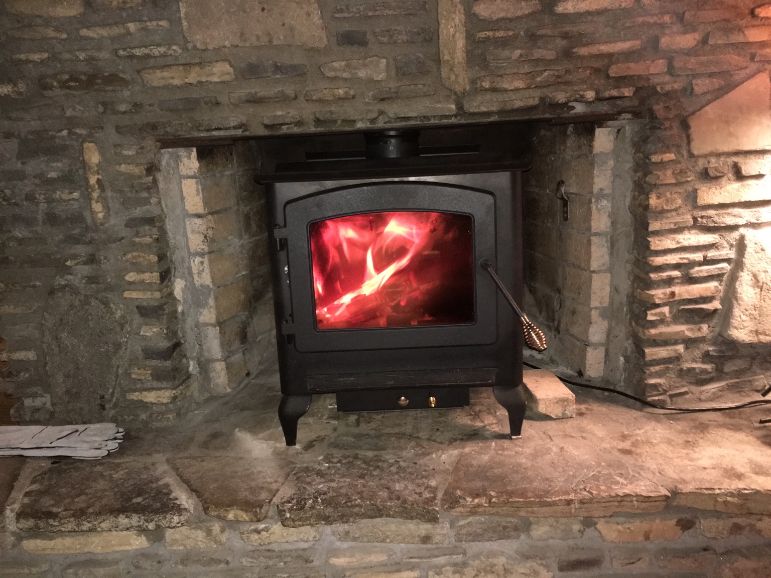

Thanks Bart. You were my motivation to go with the englander. Now if I can scrounge up two more cords of some dry wood I should be ok. I'm getting in the three year club and I've cut my next year wood already. Thanks for the shirt. And thanks to everyone here for all the advice.
Every time somebody installs one I have to chuckle. I was the first one on here to buy and install one back in 2006 and caught bushel baskets of grief about it from the pretty stove guys. In fact that is why I made the shirt design one Sunday afternoon.
