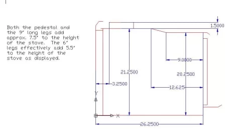

1) How big/deep is the ash drawer on the Englander 30-NC ?
2) There are 6" legs with this stove, and from what I understand , they are now being shipped with 9" legs which changes the measurements given on the site .....
Could someone please give me the measurement of your stove from the floor to the top of your flue thimble ?.....Also I need to know what the measurement is from the bottom of your ash pan to the floor .... and how long are the legs on your stove ?
I need to know these measurements as I will be buying this stove, and will be cutting down the legs to be able to fit the stove in my fireplace .... I was considering the 13- NC but I'm not sure it will produce enough heat for my cabin ....I would rather have too much heat than have too little heat ...Thanks to all in previous discussions on these stoves ... I've learned a lot ...
Thank you ..Jim

I'll let you know on Monday. Weren't you going to send me a diagram that you needed dimensioned, or was that someone else?
Thanks!

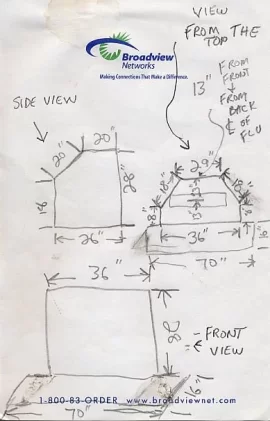

Corie,
I had sent you a PM telling you that I posted a pic on the thread we were on the other day ....I guess you didn't get it ....Jim
I'll find it again ....Jim
I hope this dimensioned drawing is helpful. If you need any other dimensions, please let me know.
Also, the ash pan is 11.25" wide X 12.375" deep X 2.25" tall.

Corie,
YOU DA MAN !!!......Thank you so much !!....This helps me TREMENDOUSLY !!..... I'm sure it will help others also !!....Jim
Glad I could help. Again, as I said in the PM, please feel free to contact me if you need any additional measurements or other information.
