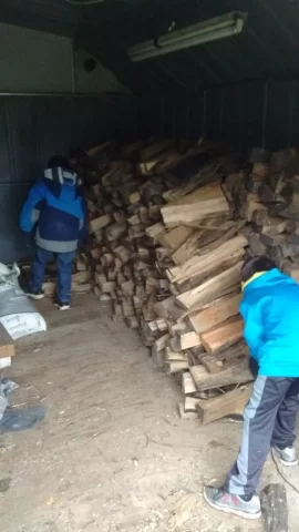

Thanks again. I have a listing in mind that says they will test the wood for you. I will be purchasing a moisture meter for myself soon too. I have plenty of wood at home to go through for now though. Does anyone have any suggestions as far as a meter goes? Brand you prefer? Here are my little guys that stacked all that wood :)

Never been able to shut mine down all the way either. Usually go all the way in then back a 1/4 inch or so. Those look like pretty small splits in the picture. Are you loading them tightly with hardly no air gaps?

I did not pack it very tight until last night. I noticed a major difference when I picked some really heavy pieces and really loaded it up. I bought an infrared thermometer today so we will see how she does tonight. I am going to pack it tighter than usual and see what temps and time I get out of the burn.
