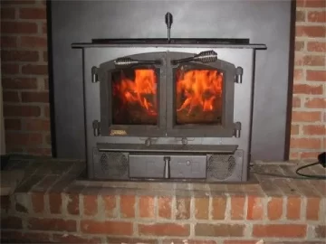

I painted it the same color of the old Sierra insert that served me so well for 21 years. A nostalgia thing.
Six years later I still miss that stove. I could set up a night burn in my sleep in that sucker.
And smoke out the whole hood and chip creosote every spring.
RIP Brownie.
  • [Hearth.com] Englander 30
