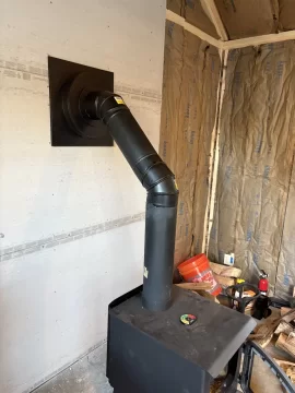

Finished my install. How did I do?
Interesting.
I ran it like you would a water heater. Since im a plumber
I had a drip of stuff on top of my wood burner.
I’ve got no idea how you would plug into the triple wall as a crimped end fits right into it but that transition piece was marked with direction of flow that was backwards. I assumed the sticker was put on wrong. Also I noticed the triple wall was backwards as you’ve said
They give no instructions on any of this. Plus duravent doesn’t answer or return calls for help.
I strongly regret not hiring a pro at this point
What should I use as a transition out of the triple wall coming out of the thimble?
IDK about the thimble connection but the single wall inside just needs to be flipped where crimps run down toward the stove.
Interesting, i did not know that you run gas vent pipe the other way?
Before reading your posts, I'd probably install it like the woodstove pipe as that what makes sense to us wood burners.
Took it apart. The transition piece makes more sense now.
I can flip it around
Ty for that. Idk what idk

Not sure if it was mentioned yet or not but the reason for the crimped ends down is so that creosote or any moisture runs down in side the pipe and doesn’t leak out of it.
As a tinknocker, it seemed counterintuitive to me as well until the creosote running was explained to me
Outside vent is 13’ center of tee to top of vent (not including the vent cap)
Inside is 3.5’ top of stove to center of pipe.
So I’ve got 16.5’ of chimney height
