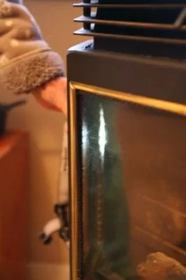

Well - it pays to ask guys who know. I just bought a new door from Englander and put it in. Didn't think to check it. You can see daylight between the left side and the bottom. The ash pan isn't as tight as I'd like it. How tight does it have to be? Can you double the gaskets and get reasonable results? Attached is a picture of the light from a flashlight coming in in to the firebox on the left side of he door. I'll Work with Englander on that. The burn Pot does rock in the cradle so I'll see if I can file one or the other flat and get a good seal there.
Thanks for the assist Everyone. When I have the door taken care of I'll let you know the results.
JW

JW,
The door mount likely has some adjustment in and with a bit of alignment will likely close properly, you need it evenly closing on the gaskets so you have resistance to pulling the "dollar bill" out.
You never trust looks for determining if a gasket seal is good, you always test.
The ash pan it depends upon how well it was machined and the shape of the latch (I looked at a few of these units at the local big boxes and saw different things on each unit that could present problems.)
When you get the door issue taken care of please post pictures of the burn pot etc... so we can see what is what.
