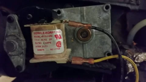

Is this a new stove or just new to you? Look on the auger motors and see if they are marked 1 rpm.
It's used. I've had it for 6 years now. This only started happening towards the end of last year. I'm not sure of the motors so I took a picture of them and can't figure out how to post the pic

Here is a picture of the motors. figured it out.
